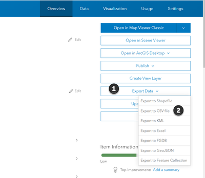

Once you have your result, you can use the Extract Data tool, or navigate to the item details page and Select 'Export Data' and choose 'Export to CSV file'
