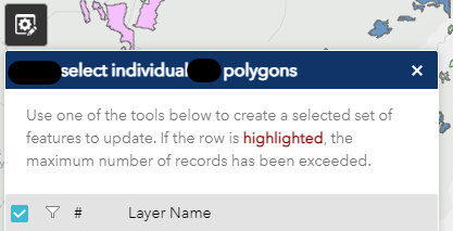

Hello,

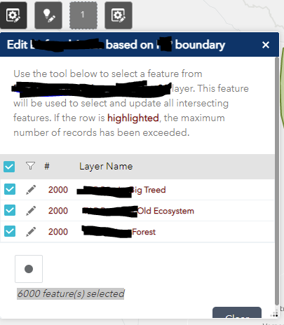

Im currently using the batch editor to take a feature layer (lets call it feature1) to intersect with another feature layer(feature2). The intersecting polygons are then edited (value changed) using the editor.
My issue is that feature1, and the selected records used for the intersect are quite large (1000s of hectares) and select thousands of individual features from feature2. this passes the threshold of the widget as you can see from the disclaimer below.
Is there a way to bypass this threshold? Perhaps in the JSON? I have yet to do much JSON editing so far so Im unaware of whats possible.
Thanks in advance.

You can change the maximum number of records returned by the service.
https://support.esri.com/en/technical-article/000012383
