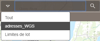

The search itself works fine, but there's 3 annoying things I need to fix:
  1. The placeholder won't appear, the search field is just blank on loading;
  2. The search tool is set by default on the first layer, but I would like to have it set on "ALL" when the app load (I would also get rid of the layer selector and have it on "ALL" only);
  3. If I can't get rid of the search layer selector, I'd like to be at least able to change the name of the layers in the menu to something more meaningfull to general public.

SébastienMartin
Amazing! Thanks Robert! One last thing, would you know any way to set the default search to 'ALL' and change its placeholder?

SébastienMartin
Thanks again Robert! But I can't find this snippet in the files of the basic-viewer template (GitHub - Esri/Viewer: Viewer is a configurable application template that enables you to display an A... ) exepted in the "demoMap.js" file. But when I add the two lines there is no effect.
Should I add the whole snippet somewhere?
Thanks!

SébastienMartin
No, I noticed the typo!
This template doesn't use a json file, the custimizations are in the default.js file. But I figured it out: in the SearchSources.js file, in the public methods you have:
    createOptions: function() {
      return {
        map: this.map,
        sources: this._createSources(),
        activeSourceIndex: this._getActiveSource()
I replaced the "activeSourceIndex" parameter with "all" and I have the search tool set to all layer just like I wanted. Putting null there was selecting no layer at all (no placeholder shown either).
