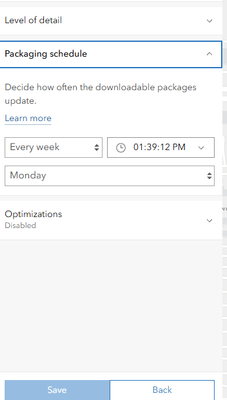

If I understand your question correctly, you can set a Packaging schedule within the Offline settings of Field Maps Designer. I doubt this would affect any offline areas that individual users create in the app though. I assume users would also have to redownload the offline area anytime it is repackaged.
