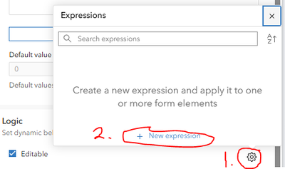

MarcyC
Thanks RPGIS! If anyone looks at this in the future here was my work flow:
1. Create a field named “Acres”
2. In Field Maps Designer
a. Select layer
b. Select “Acres” Field > scroll to the bottom of the Properties pane
c. Select “ New Expression” > add Arcade expression:
// Calculate the area using the geometry
var geom = Geometry($feature)
if (IsEmpty(geom)) {
return null
} else {
return Round(AreaGeodetic($feature, 'acres'), 3)
d. Click the drop down arrow next to the save icon to “Save to layer” this will save the expression and apply to all the maps this layer is in
I also like this blog post where I got the arcade expression: https://www.esri.com/arcgis-blog/products/field-maps/field-mobility/common-calculated-expressions-fo...
