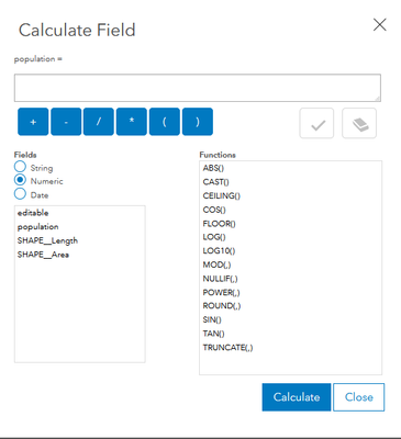

If you go to the Data tab on the content item in AGOL, you can open the field calculator there by clicking on a column heading.
Clicking Calculate will open the Calculate Field window, in which you can utilize various SQL functions.

There's this page here, but even though it mentions Arcade, I believe that is only if you're working with the hosted layer from within Pro.
