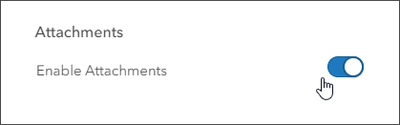

Another way is to enable feature attachments. Once enabled, you can manually add photos/images/files as attachments to each feature. To enable attachments, open the newly created hosted feature layer item overview and click on the layer in the Layers section.
Once opened, down on the right side of the page you can enable attachments.
Once enabled, you can open the Data tab for the hosted feature layer, locate the attachment field, and click Add to add one or more attachments.
Another way to add attachments once they are enabled, is to click Edit from the Settings (light) toolbar, then when you select a feature you will see an option to add attachments to the feature.

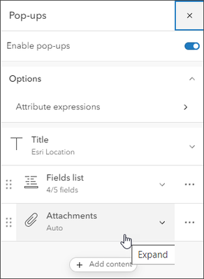

Once enabled, you can add and configure an Attachments element in the layer pop-up.
