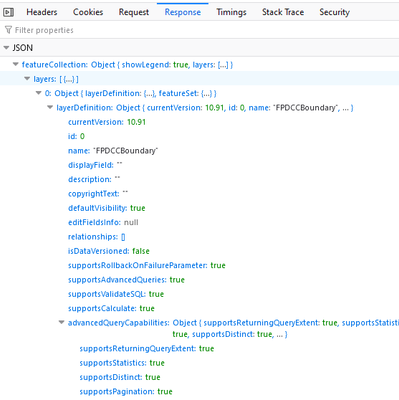

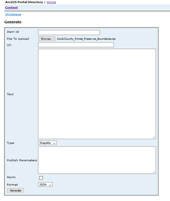

Oh, that! Yes, it's just temporarily stored. You can see what's going on in the background at your-portal-url/portal/sharing/rest/content/features/generate.
The generated features are a JSON FeatureCollection, which is being temporarily cached by your browser, but goes away when you leave the map.
