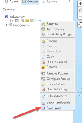

So you can save templates to the layer/item itself. If you would like to have the templates every single time you use that layer/item elsewhere, save it to the item itself:

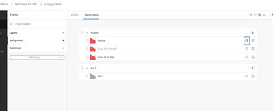

In addition to Map Viewer classic, you can also manage your feature templates in Field maps web designer and save it to the item. This will ensure that any time the item is loaded into a map, the templates are exactly as you have configured them before.
  1. Open the Field Maps Designer app
  2. Find the layer that you want to edit feature templates for.
  3. Click the Templates tab, then the Add Template button fill it out as desired.
  4. To edit an existing template, select the template and adjust changes as needed.
As for the second part of your question, yes you can have multiple templates for a layer but this would be saved to the item (so you cannot have multiple templates for different maps).
