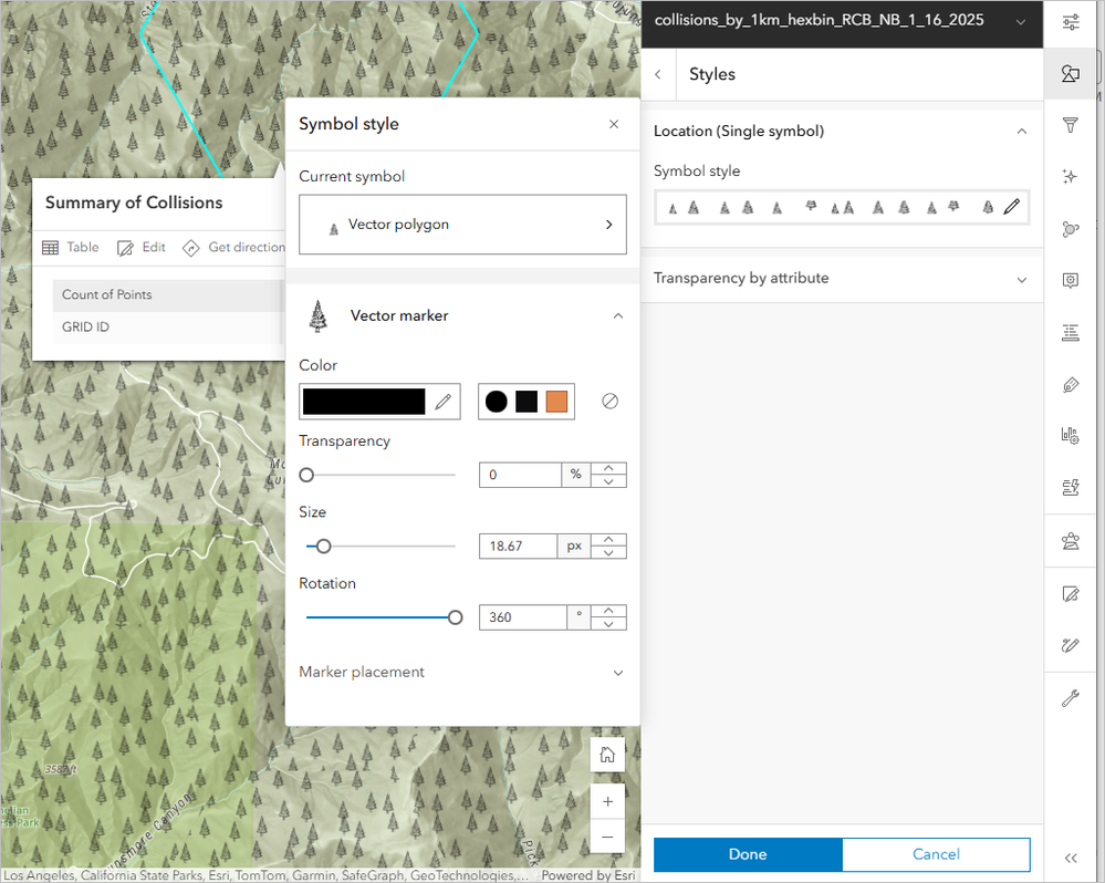

You might look at using a vector polygon fill for your tree polygon layer. It is not the same, but you can get a good effect.

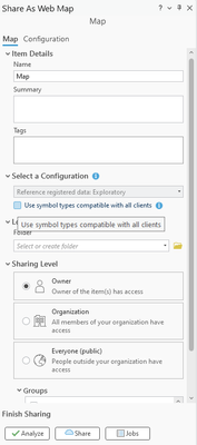

I would try enabling the 'Use symbol types compatible with all clients' check box and see if that makes a difference (located just below Item Details, under Select a configuration).
 Otherwise, as suggested above, use common ESRI project style symbols and you shouldn't have an issue.

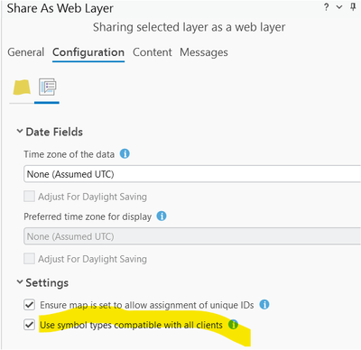

I have attempted this suggestion using the same style and this has worked for me, just to note at 3.4 ArcGIS Pro the location of this setting has moved from the above screenshot
It is now under the configuration tab as seen below.
