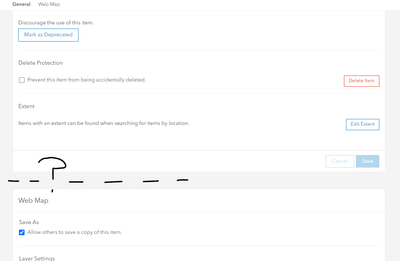

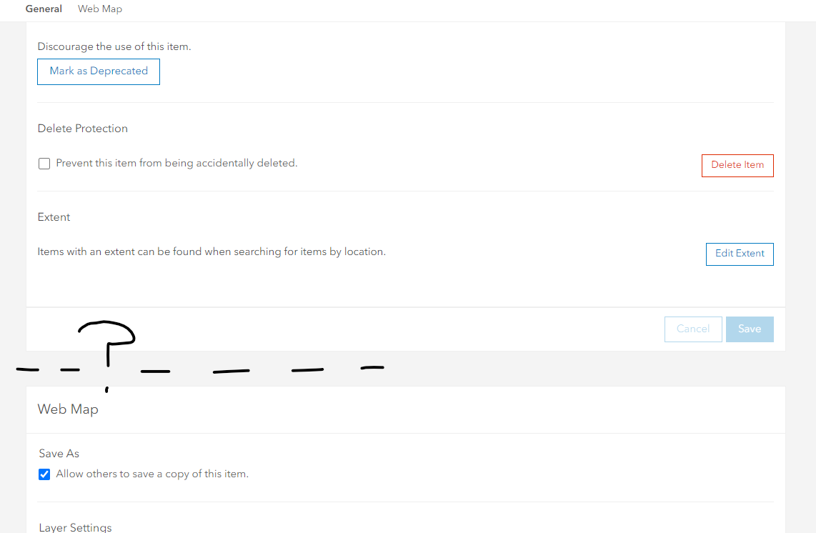

Hi,
I am trying to make an offline webmap with a joined view layer which can be used in the Field Maps app. The joined view's original layer already has syncing enabled. However, the offline options don't show in the settings tab of the webmap:

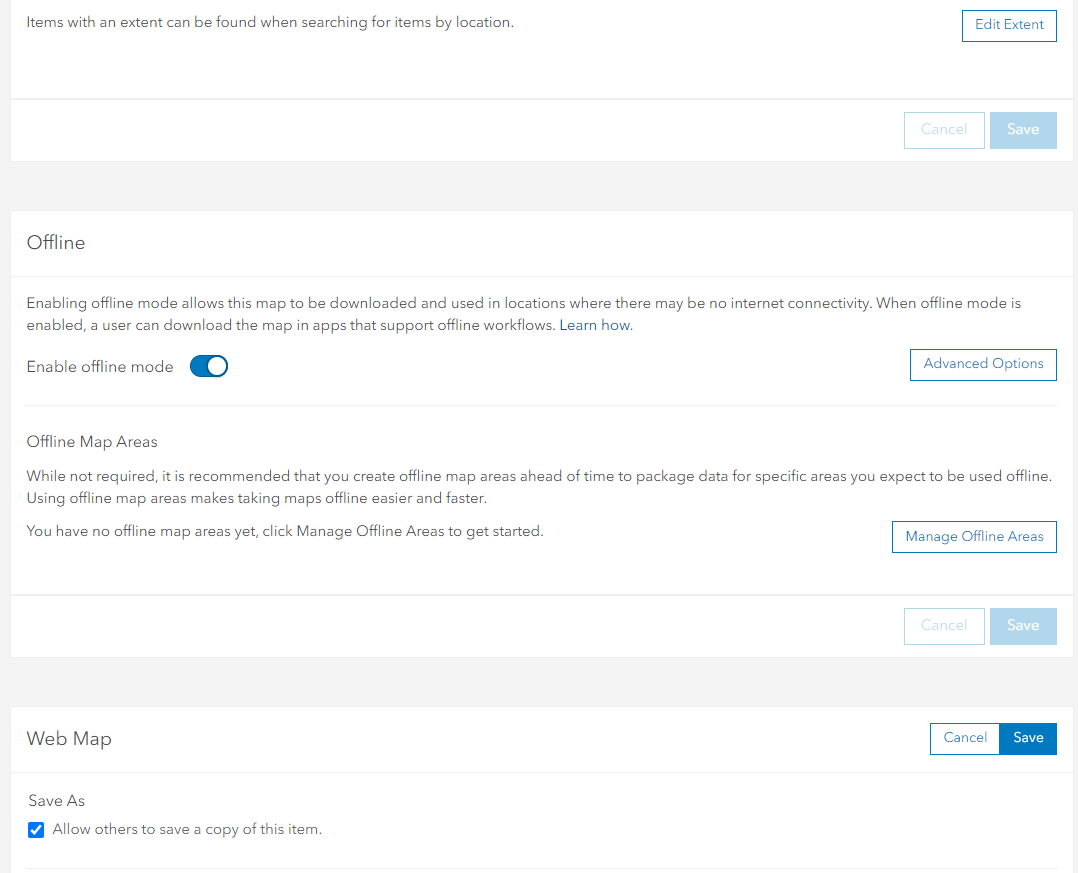

 This has been done before with web maps that were created in the same portal and also with joined view layers. I expected to see this:
 Does anyone know what is missing to allow offline usage for the webmap?

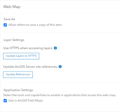

Thanks, @doketwaj  - yes, I do have a developer account linked to the account used for doing this. Is that a requirement for taking maps offline?
There is no option for enabling / disabling address search within the map settings. The only options that I have are the following:
