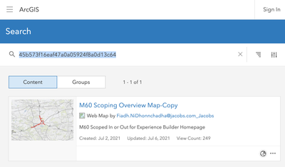

Jianxia
@JonathanHallam1it turns out the overview map is not shared publicly. When I open the map in the incognito window, a sign in dialog pops up.
https://www.arcgis.com/home/search.html?q=45b573f16eaf47a0a05924f8a0d13c64&showFilters=false
Jianxia
However, once I sign in with my AGOL account, the map opens. So this tells there are some Subscriber content from Living Atlas in the map. @AlixVezina found it might be this subscriber content that causes the issue.
https://www.arcgis.com/home/item.html?id=0895f24cf85b4251990a24305447ded7
Looks like Experience Builder is not able to detect it automatically. When the app is published, the Subscriber content window from ExB should pop up and ask you to grant permissions for the public access. As a test, could you please remove this item from the app?
