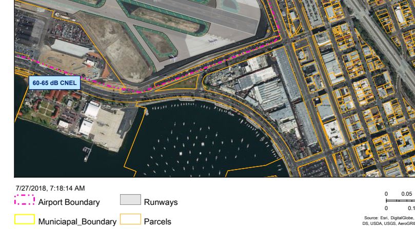

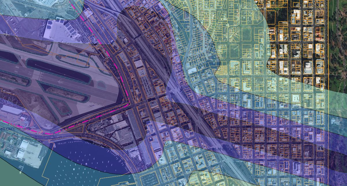

Hello,
I am trying to get my layers that I have turned on to display on the printing widget but when it pdfs the layers that I display in the web app do not display on the pdf?  I don't have any developing skills so any help would be appreciated.  Thanks, WayneScreenshot from web app displaying a layer.Screenshot from pdf created with printing widget not displaying what was on my screen in the web app.

CSCompanies
Hi Kelly,
Thanks for the response.  The colored layers in the first image are not showing.  The second image is the pdf I am getting in the print widget.  The layers are all on ArcGIS online.  I basically shared my ArcGIS Pro document with all the layers as a web map and then created the web app.  Thanks, Wayne
