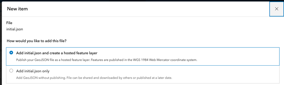

Download the zip file with two JSON files. The initial.json contains a FeatureCollection with a single feature containing a single property.
After that I upload the file to ArcGIS Online and create a hosted feature layer
This will work without any problems!

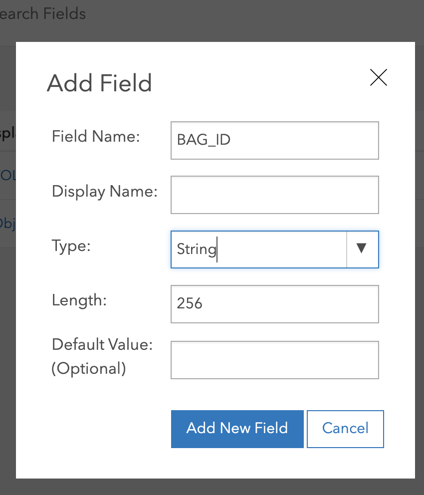

The second file insert_w_extra_column.json contains also a FeatureCollection with a different feature and also an extra property called BAG_ID. This property is formatted as a string and must remain a string. Before I upload the second json I add an extra column like this:
After adding the column I confirm that the column has been added and is empty because the first feature didn't contain the initial column.

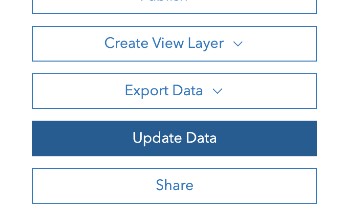

Ok now for the final part. I update the existing feature layer with the second json
I select the first option "Add Features" and the let ArcGIS Online automatically match the columns for me.
Following the update action I get the green confirmation at the bottom of my screen.

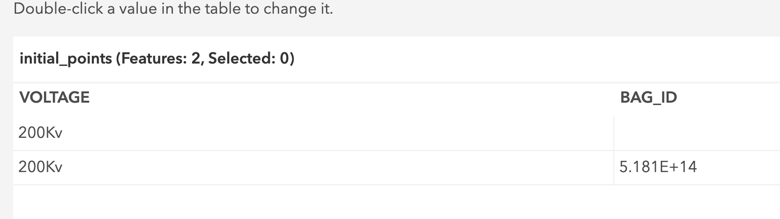

Above you can see the final result of the update operation.

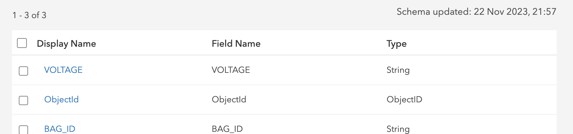

  • The ArcGIS Online column is also still of type string
  • The final number in ArcGIS Online is displayed as a scientific number
  • If I download the layer as GeoJSON the output is formatted like this

Why is this the case, this doesn't seem intended? It is kinda important for us as the ID gets lost in this way.

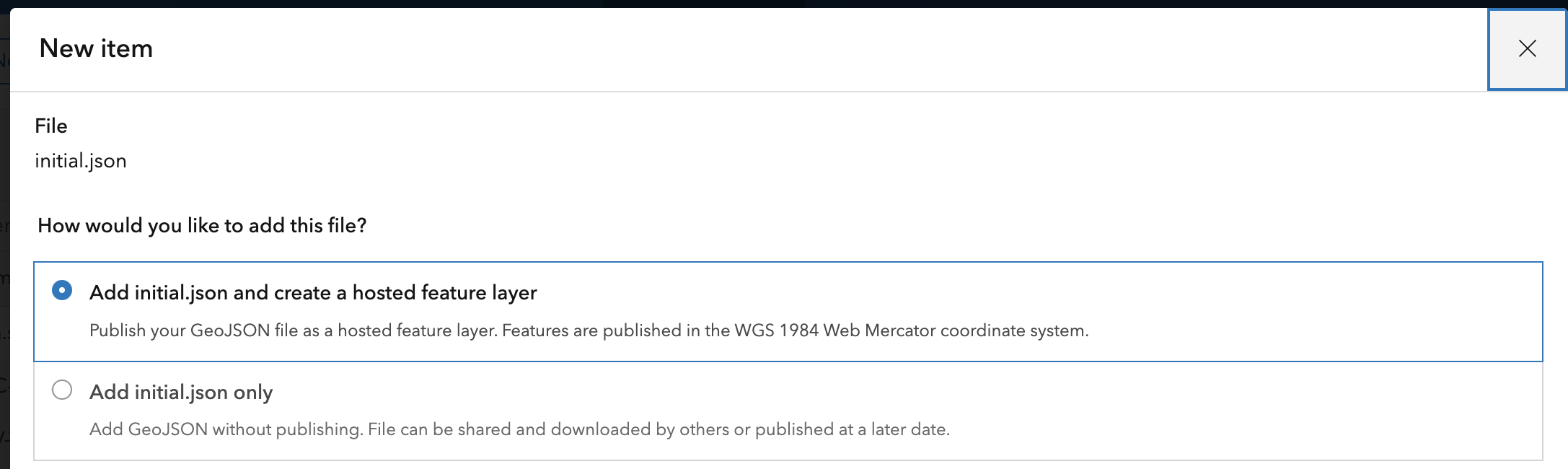

Ok I just made an easier test case with the same output. Uploading the second json (with the extra column) twice. First as the definition layer and then as the update. See my screen recording here:
