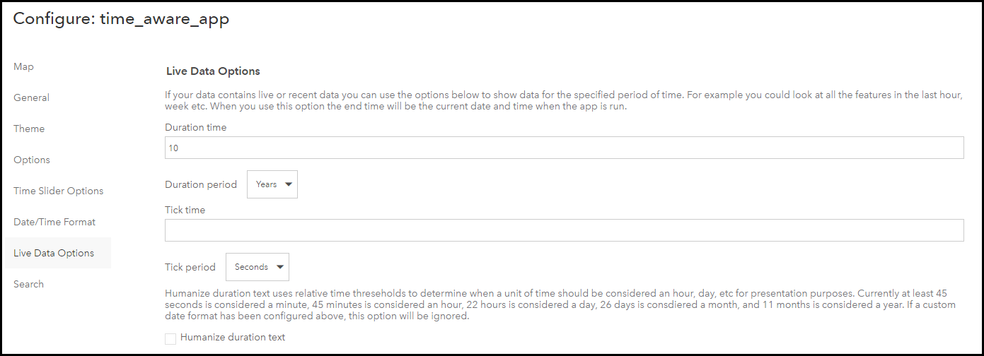

You could use the Time Aware App. There is a tab called Live Data Options available when configuring the app which will use the date the app is being accessed as the end date:

Hi Ryan,
The time settings in the web map viewer are only for historical data. It doesn't handle time data that is still being accumulated. You can read more about it in our documentation under the Time Span section:
Configure Time Settings
RyanNosek
Thanks for the info Katie! Unfortunately, was hoping to incorporate into an existing app, as just another way to view/query the data. Would like to see a Time Aware Widget implemented in WAB in future release Web AppBuilder Custom WidgetsArcGIS Ideas
