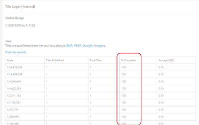

David_Brooks
MVP Regular Contributor
Yes if you create a tile layer and publish to AGOL, it does take some time for the tiles to publish into the Hosted Tile Layer. You can check on the progress of the publishing service in the settings of the item.
