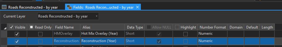

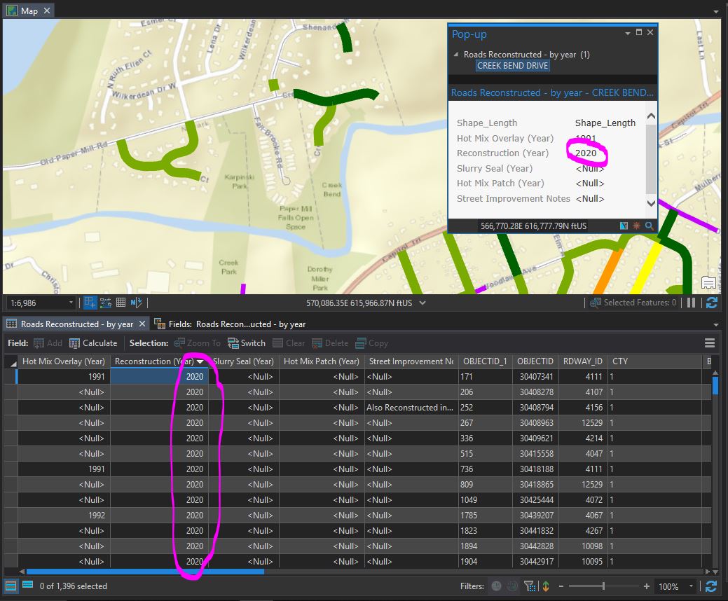

I have an ArcGIS Online hosted feature service where I keep track of the last time we milled and re-paved a street (I call the field Reconstructed).  The field is a short interger field and when I did my edits in ArcGIS Pro it all seemed to show up as expected, and as I have done for the last couple of years.

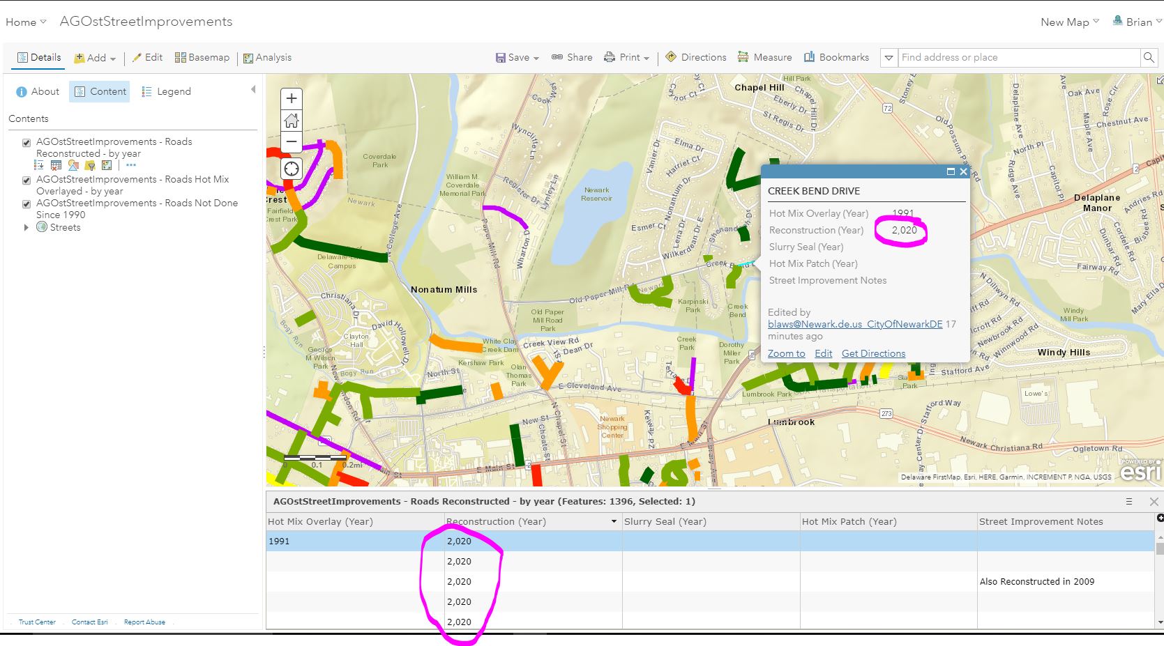

But when I went to my web map where I have this layer contained and the new data I entered all have the thousand separator column everywhere.

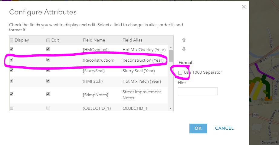

So the first thing I think of is to check the popup configuration to make sure the thousand separator box is unchecked and I found that it is indeed unchecked, just as I had previously set it up.

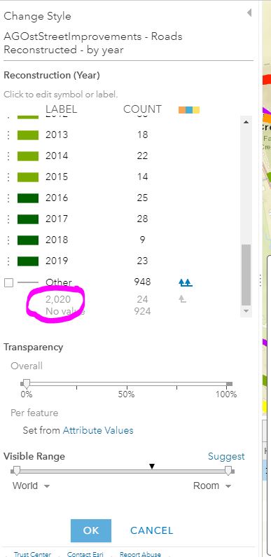

I've tried bringing this layer into a new web map and playing with the configurations and saving the new web map, to no avail.  I've also played with with the visualization settings on the layer itself to configure the popups, and that doesn't work either.  I'm at a loss as to why I cannot seem to get rid of these separator commas and would appreciate any other ideas I could try.
