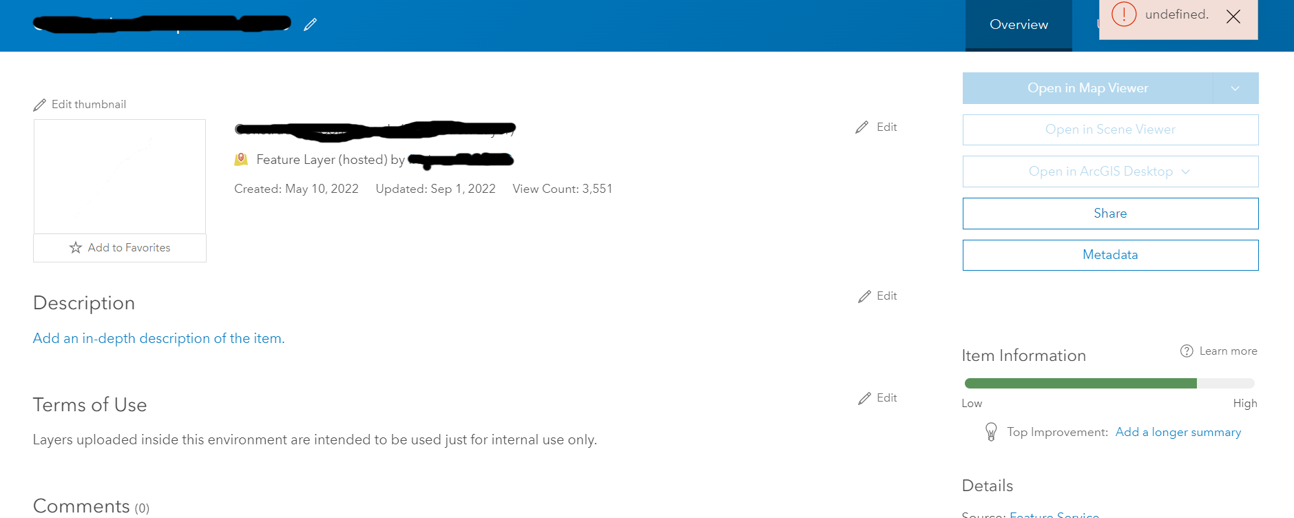

Lately, we are having issues with ArcGIS Online. Layers are having issues in loading in Web Maps/Web Apps, raising an error in loading the layers. When i reload the App/Map the layers that can't be loaded are not the same. Also, when i try to open a single layer sometimes i'm having this issue(not always and not in all layers).
Im not able to understand if the issue is in my data or in the server side.
