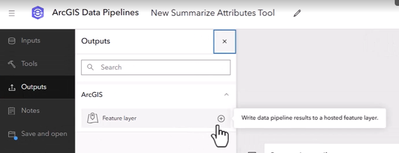

EmilyGeo
Hi @HingFungChan
It looks like the output that you created is a table. Tables only contain attributes (fields), and do not contain any geometry.
One option for working with this table is to upload the CSV file as a "New item" in My Content and specify the X and Y fields containing the coordinates, then publish that as a hosted feature layer.
However, keep in mind if you prefer to create layer outputs in your data pipeline, you can do that using the Output tool. That way you will have a layer that stores geospatial information in addition to the attributes:
Hope that helps! Emily

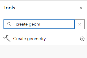

EmilyGeo
One option would be to add a layer with location data to the join if you have one available.
Another option would be to try the Create geometry tool
HingFungChan
Thx so much for your answer, I have been stuck in this problem for weeks. Truly appreciate it.
