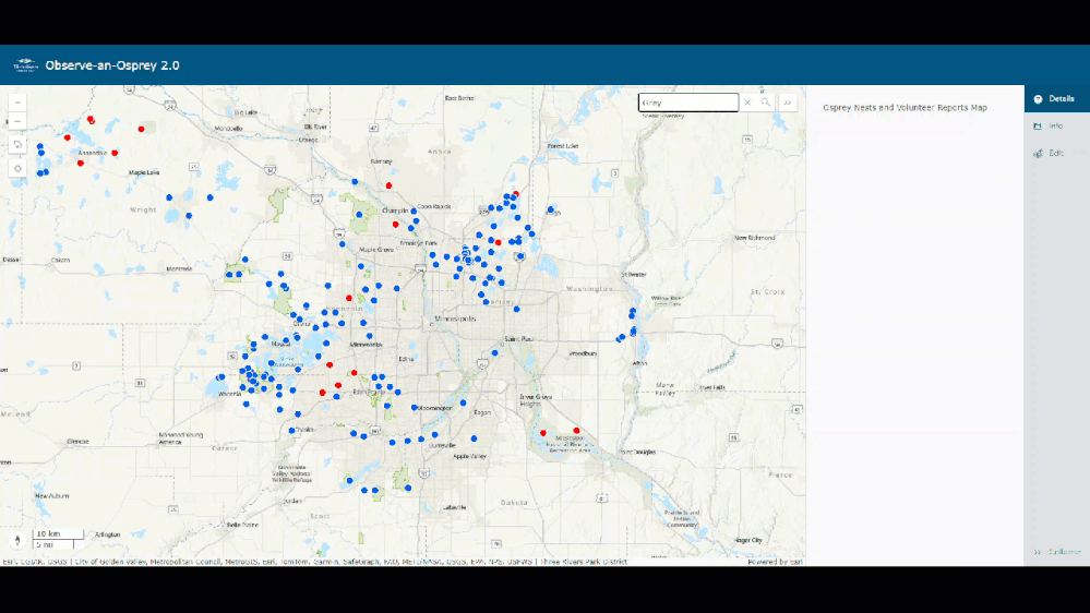

Hello ArcGIS Online Team,
It appears that the Sidebar Instant app's popup panel breaks after submitting an edit through the editing widget. Please see screen recording below:
Editing in the map viewer works with no issues, I have tested by:
  • Duplicating the app out
  • Creating a brand new sidebar app from scratch
  • Testing a different dataset
  • Testing a hosted dataset
None of these workflows has resolved the issue.
Any assistance would be greatly appreciated.
Thank you,
Amanda Huber

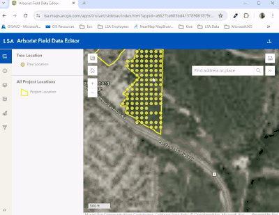

I'm noticing similar weird behavior in a Sidebar instant app with editing enabled. Even before editing anything, it seems like something is wrong. I can click on a feature and see its popup initially, but when I try to click on a second feature, nothing appears in the Info panel and the first feature remains selected.
I'm observing the same issue in Edge and Chrome. Unlike @Amanda__Huber's layer, my editable layer does not have related records.
Here's a screengrab:
- Holly

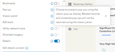

@Amanda__Huber I just happened upon this post that seems to explain our issue and maybe provide a workaround until it is fixed: Sidebar Instant App Pop Up Feature Not Working - Esri Community.
Edit: Actually the Classic Panel option might not work for you since it apparently can't handle related records. 😞
- Holly
Amanda__Huber
MVP Regular Contributor
@HollyTorpey_LSA
THANK YOU for sharing this! This seemed to have resolved our issue with the popups as well as the search bar issue explained here: https://community.esri.com/t5/arcgis-instant-apps-questions/sidebar-instant-app-pop-up-feature-not-w...
I did some testing with related records, and it appears that the related record editing is visible through the classic panel too somehow (?) but YAY!
