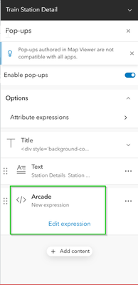

AndresCastillo
MVP Alum
it works for me like this:
var baseurl = 'https://www.something.com/route/'
var code = Lower($feature.ColumnName)
var train_stations_public_page = Concatenate([baseurl,code])
Console(train_stations_public_page)
var train_stations_public_page_link = '<strong><a style="color:#01507b;text-decoration: underline;cursor:pointer" target="_self" href="' + train_stations_public_page + '">Station Details</a></strong>'
Console(train_stations_public_page_link)
return {
	type : 'text',
	text : train_stations_public_page_link
This way, I can change the page in-place, instead of opening a new tab.
Thank you @rdbutger !
