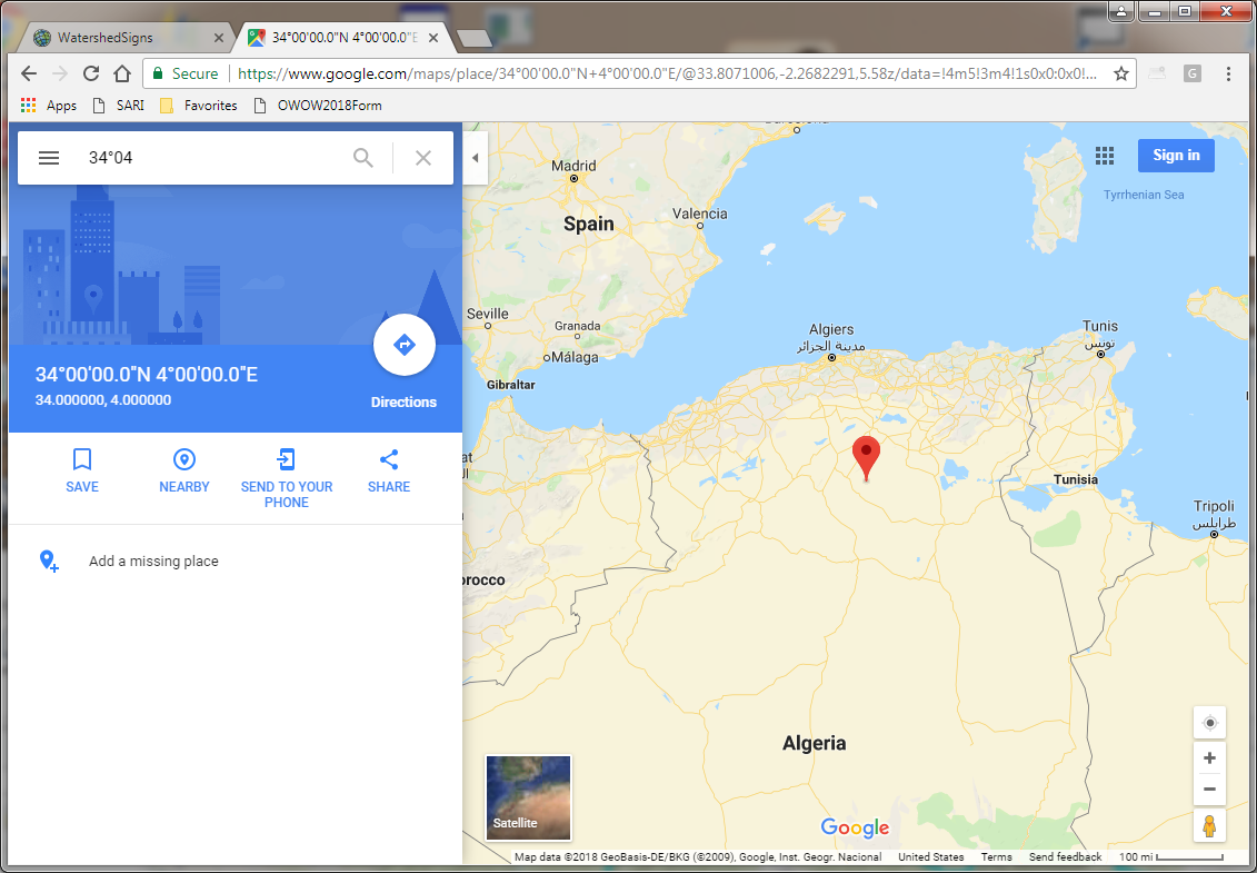

when I I click the link in ArcGIS on line it goes to a place in the northern part of Algeria

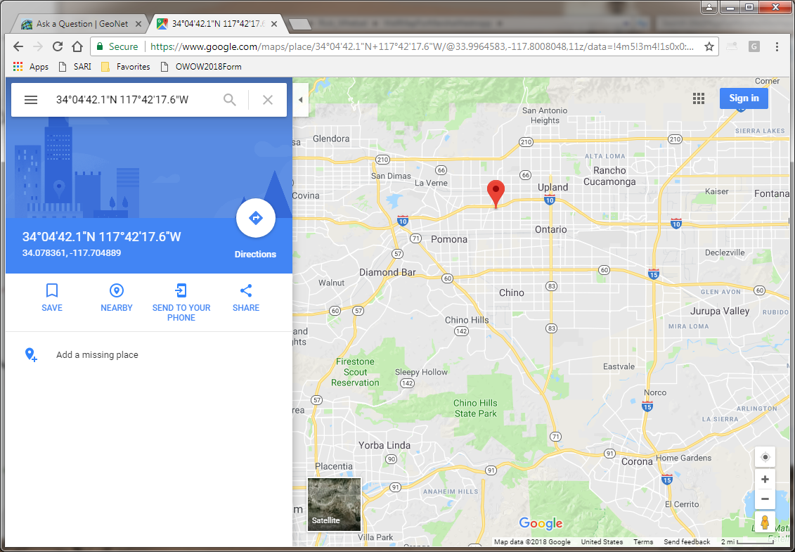

it should be going to this location as it correctly does in ArcMap:

The quote by the 04 was truncating the href url early. Ti avoid this issue, try using double quotes if a single quote is contained in the url. Using the shortened link will remove the need to do this.
href='https://www.google.com/maps/place/34%C2%B004'42.1%22N+117%C2%B042'17.6%22W/@34.078349,-117.7070777,1...'>More Info</a>
