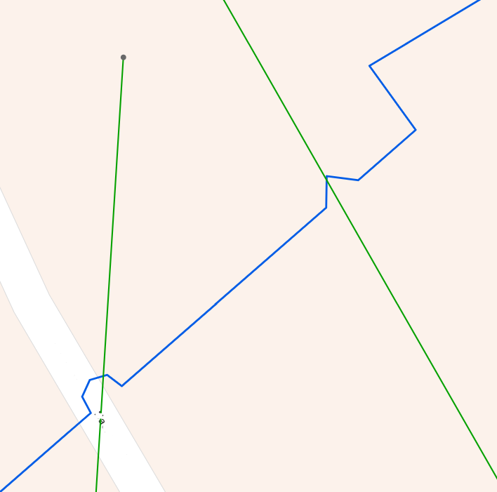

In our water network data we use "loops" in lines to display areas where pipes overlap but do not intersect.  We noticed yesterday that in ArcGIS Online (Experience Builder and Field Maps) that the curves are drawing with much less detail.
This is what they look like in ArcGIS Pro:
And this is what they look like in ArcGIS Online:
I checked the settings of the layer and confirmed that we are not using the "Optimize layers" setting to increase drawing speed.  For reference, the layers in ArcGIS Pro are coming from our enterprise geodatabase via services from ArcGIS Enterprise, and the data is published to a hosted feature layer in ArcGIS Online.

Hi - This is Ann Wang from ArcGIS Online hosted feature services team. ArcGIS Online only supports curves on the backend so it is as designed that the curves will be densified on Map Viewer. This case is on a tiny scale so the drawing loses its detail. However, your data should be untouched and kept as curves as they should be. Please let me know if you have other questions!

My question would be - how do we go about making the curves display correctly?  For the last ~8 years that we've used ArcGIS Online the curves have always displayed correctly in all of our web maps; the change to a less-detailed view was just noticed this week.  Is there something that can be done in the web map or layer settings that would make them draw correctly again?
