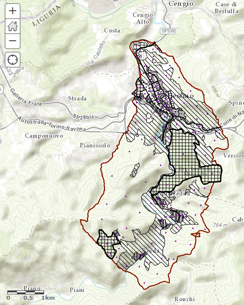

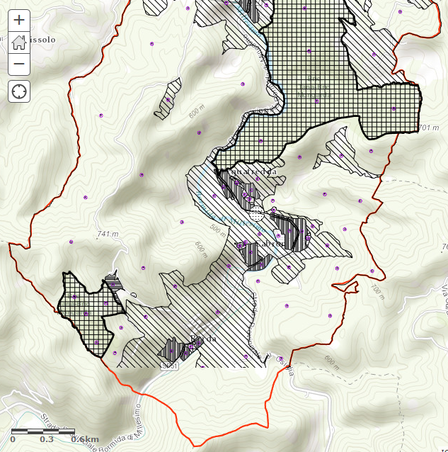

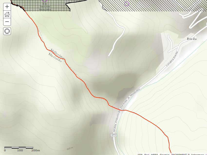

Here is a screenshot of a Web Map for different level of zoom showing a "working" tile layer (the red line) and s "corrupted" one.
low detailmid detailhigh detail
