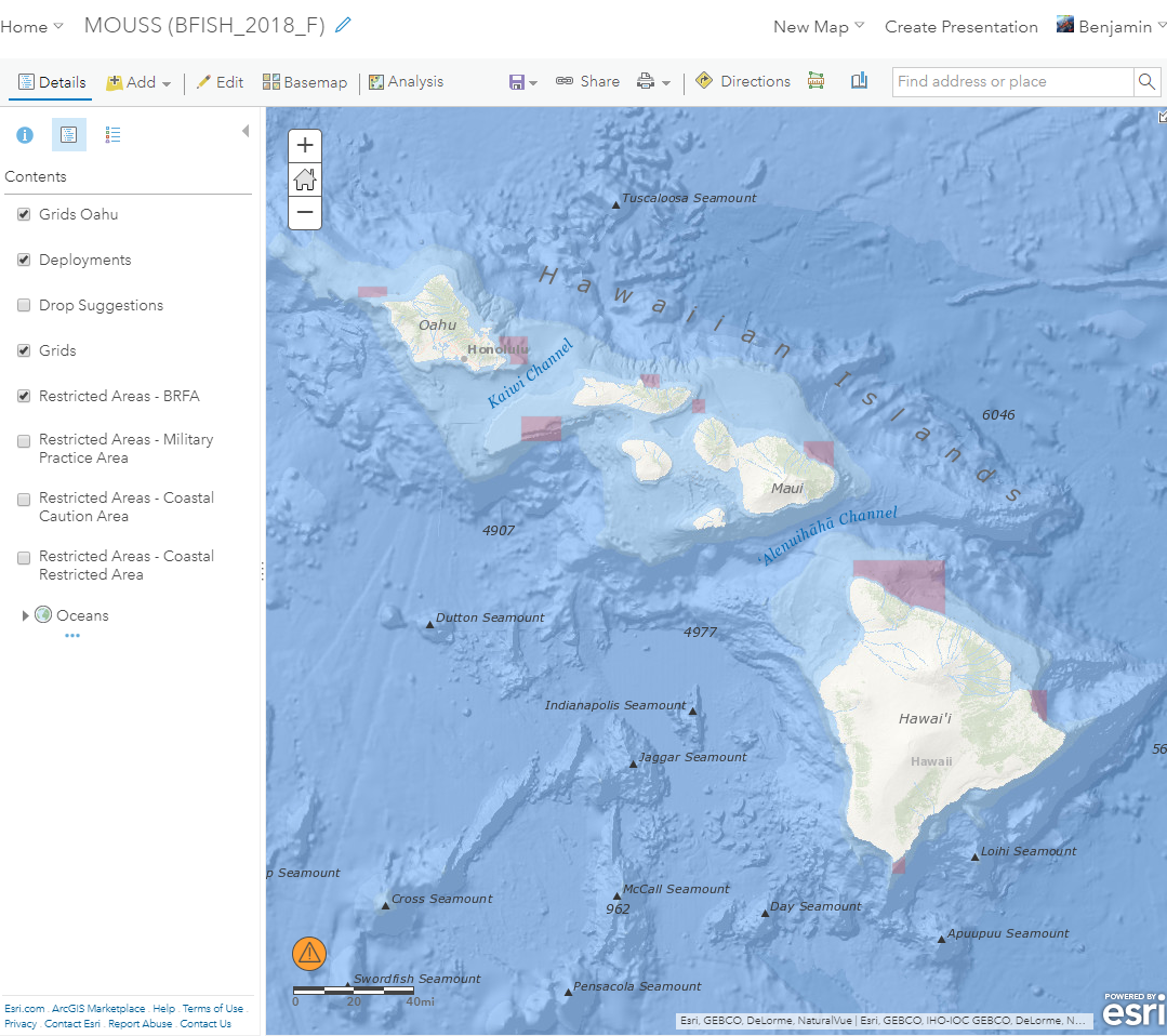

I seem to be having the same issue as Ms. Baker and others.  I have a layer (Feature Layer (hosted) with Service Definition) that is not drawing properly.  This is a large feature layers with approximately 2000 features. I have confirmed that the Max record Count is set at 2000 and have tried rebuilding the spatial index for the layer.  All to no avail.  Has anyone found a solution?

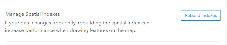

I rebuilt an index for one of our users who couldn't do it for himself even though he's the data owner. The user was able to check a box for rebuilding, but the rebuild button never activated for him. I'm an admin for our organization so I'm wondering if this is related to a privilege, maybe?  Is it the "Edit with Full Control" privilege? At any rate, his hosted layer draws now. This post has been very helpful.
