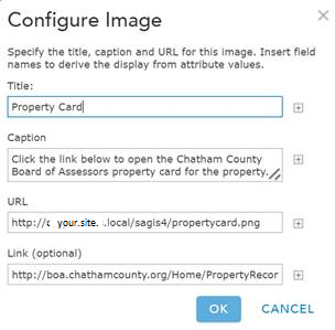

Now.. another handy trick (and yes this works with the approach above) is in ArcGIS Online web maps you can put a link or multiple file links in, as a "image". I screenshotted (with the Snip) the word "Property Card" to create links to our property cards. The 'word' Property Card, as a PNG image, appears at the bottom of the web map's pop now.  You can make multiple "links" with this workflow. It works great! Our users LOVE it!   Oh I should note, it goes to the right property card below because I put {PIN} at the end of the URL and that is how it looks it up on the backend.
