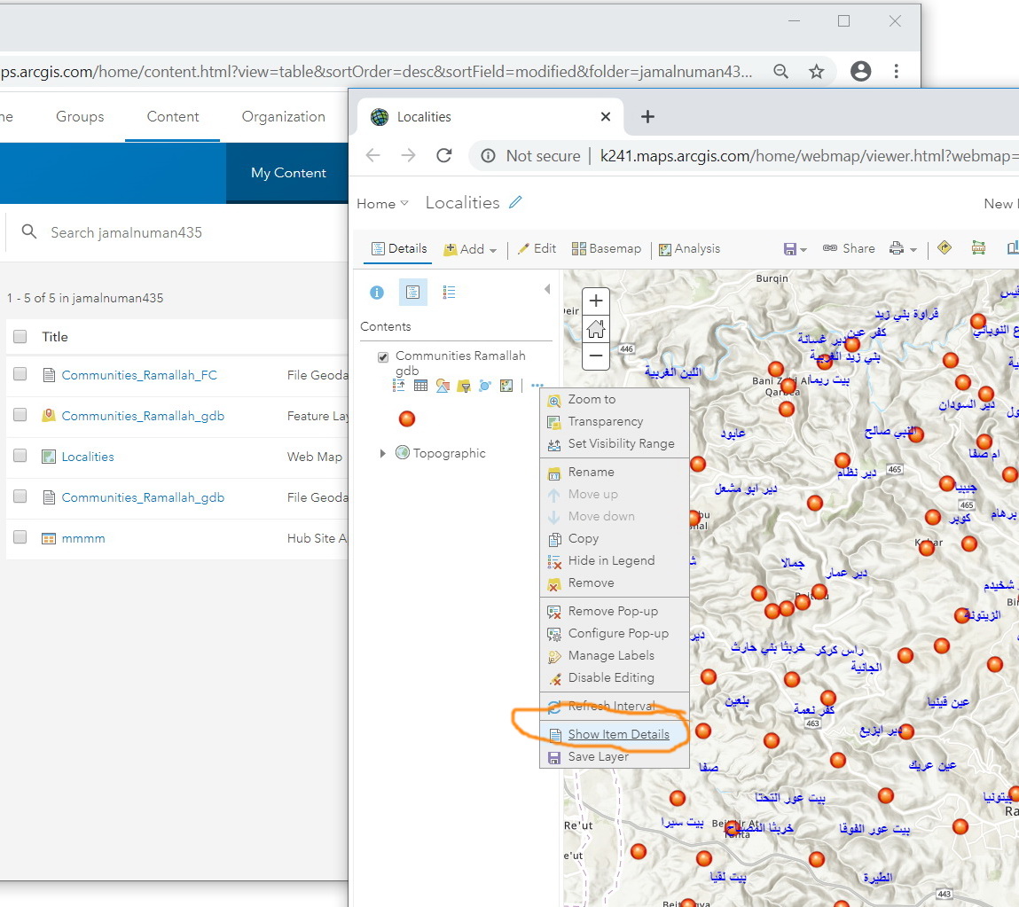

I’m not sure if there is a tool by which layers can be downloaded while working with “map viewer”
Jamal Numan
8 Replies
Katie_Clark
MVP Regular Contributor

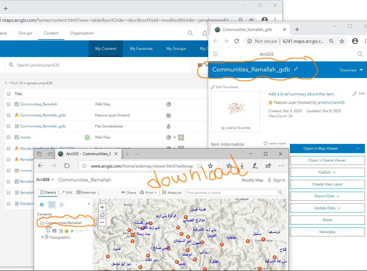

As far as I know, this cannot be done in the map viewer directly. You can share the map as a web application and use the "Analysis" widget, which has export functionalities, or access the layers Item Details page using the Table of Contents in the web map (see screenshot). From there, you can download the layer as various file types (fgdb, shapefile, etc).

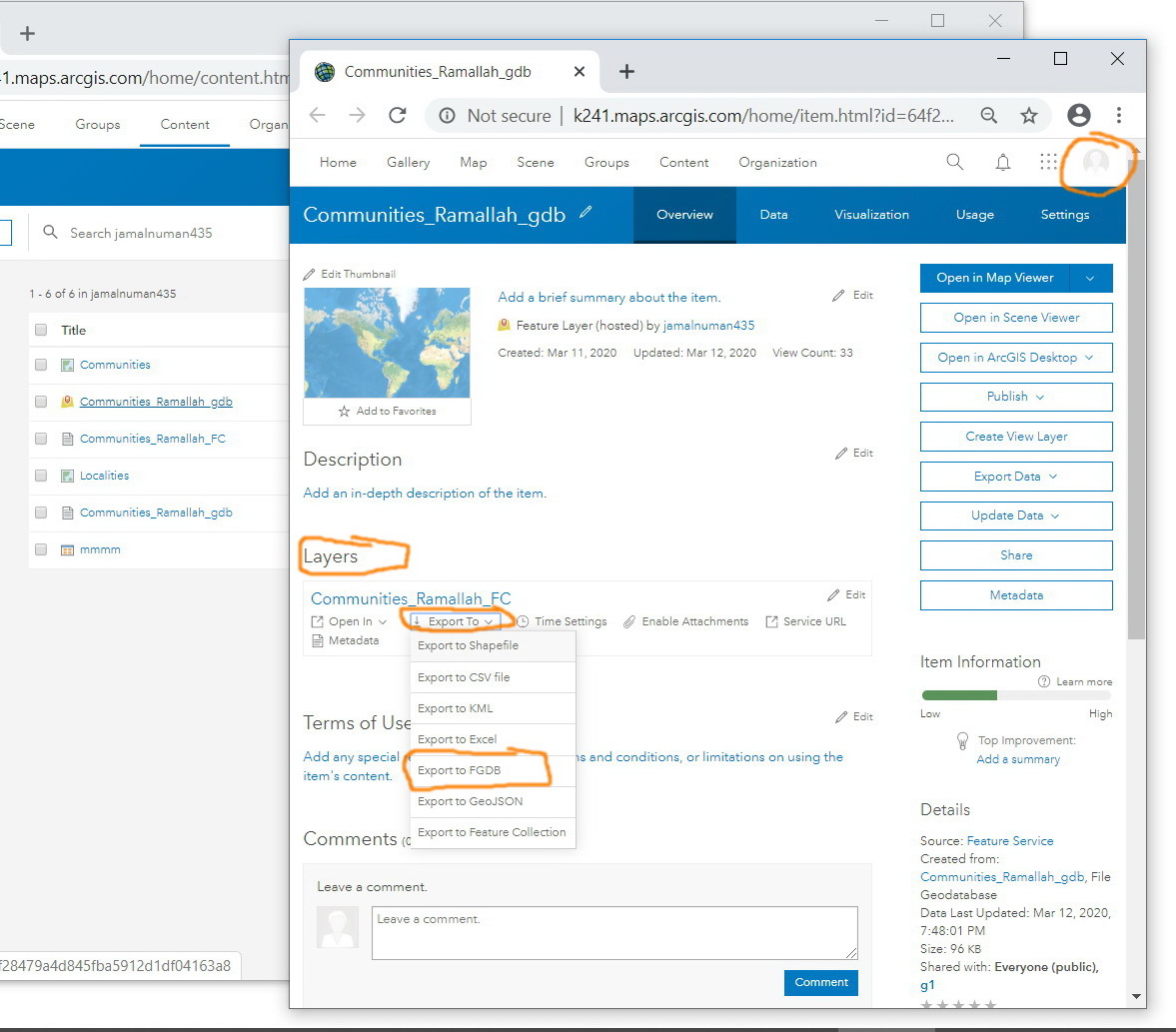

If you only want to export a particular layer from the service, you can use the "Export To" option under the layer name:

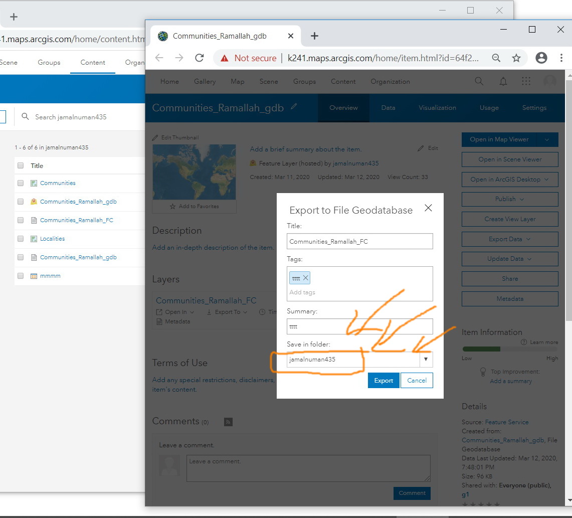

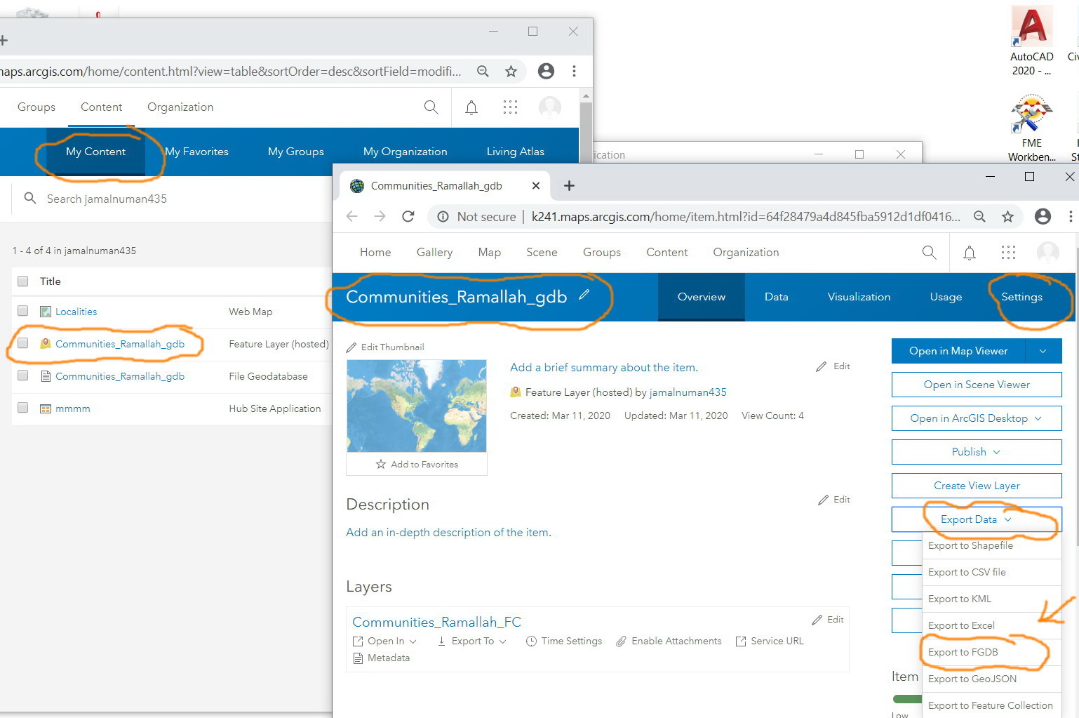

Yes, unfortunately it is not an option to have it download directly to your local device. It is saved in your content as the desired export format. Once it is exported, go to that item and click the download button from there. Once it's downloaded to your device, then you can delete from your content in your Portal if desired.
