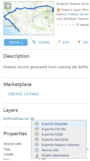

Do you require a programmatic solution? If the user owns the item, they can effectively make the above call in the user interface to create an item from the feature layer. Then, the could download the item if they want it on their computer. Go to the feature layer item, look in the Layers section and click the small arrow next to the layer name for the export options.

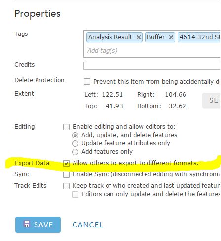

If the user doesn't own the feature layer item, it may still be possible to export the item if the owner of the feature layer enabled export. On the feature layer, the owner can edit the properties and toggle the export property.
