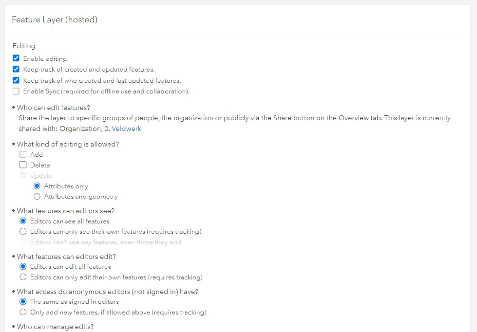

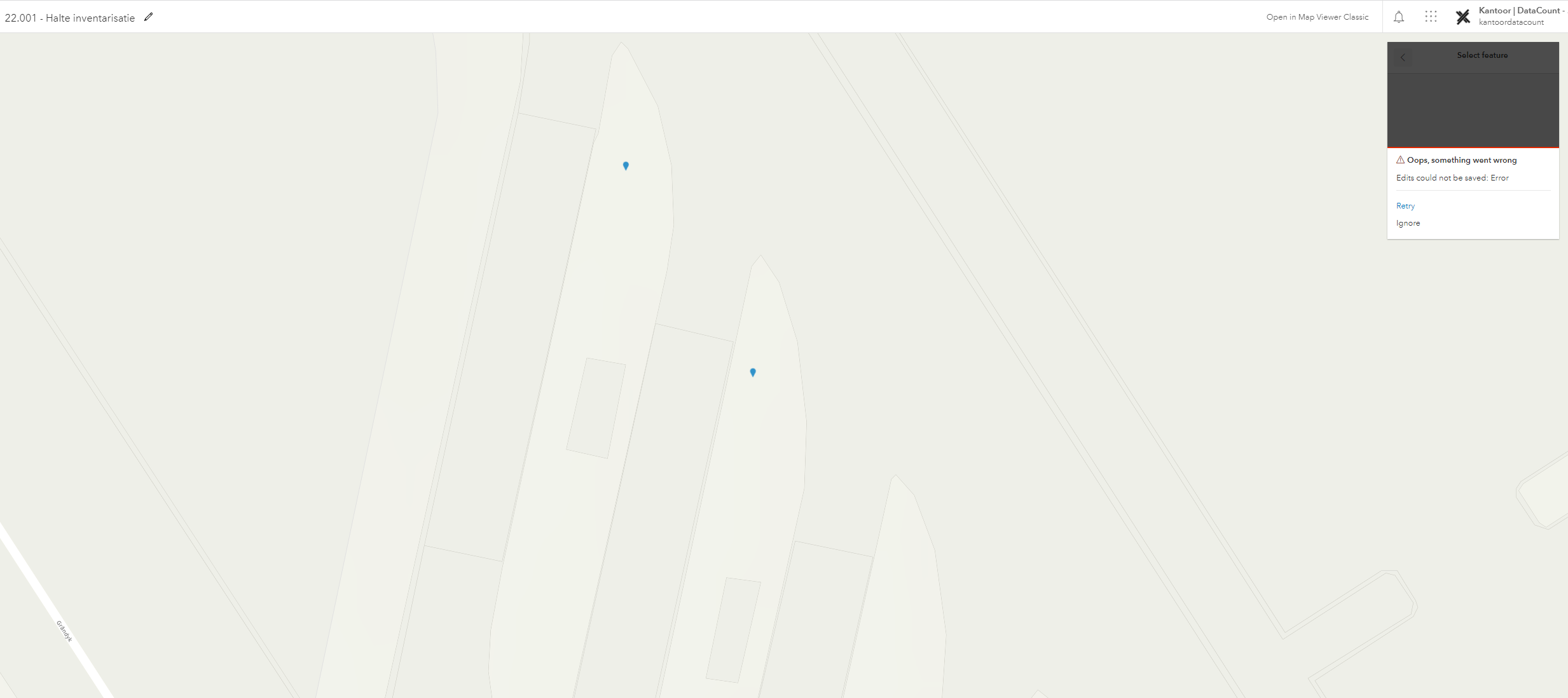

I'm having the following error while editing data that's been uploaded recently: Oops, something went wrong, Edits could not be saved error.
The features are editable cause these settings were on:
It doesn't help to load the data in a new map. Weird enough it is possible to edit the data while loading in Map Viewer Classic without having this error. So it seems to be a Map Viewer problem. Is somebody else issueing the same problem?

Hello,
At first glance I would say to check off the "Add" and "Delete" and possibly the "Update" check boxes?

Thanks Amanda, for your reply!
We tried your suggestion, but that doesn't fix the problem. When all boxes are unchecked, the edit modus in the Map Viewer turns off as it should. When the boxes are checked again, the same errors appears when we try to save edits. Therefore, it seems like it's not related to the kind of edit options.

However, we did find the solution: a textfield had '<Null> written as text, instead of a real Null-value. By recalculating the values to a real Null, we managed to save our edits.
