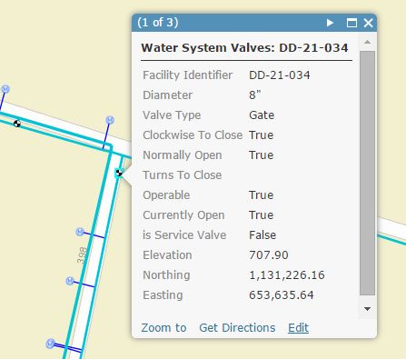

I want to edit the valve's open attribute:
I click the valve and click edit:

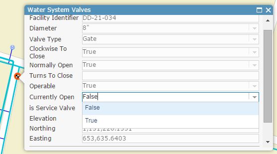

I change the Currently Open attribute, notice the symbology change:
Edit appears to be made:
