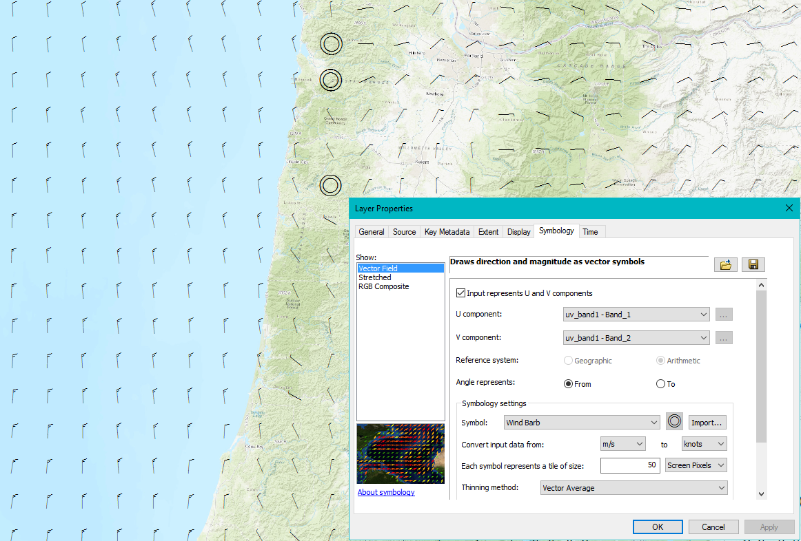

I have been using the "Vector Field" option for displaying wind barbs from raster data representing the U,V components of wind speed. I'm pretty happy with that in Pro or ArcMap, since it works with the data I have, so I don't have to convert it to vector data. Here is the methodology I'm using.
Drawing raster data using vector symbols—Help | ArcGIS for Desktop
I was wondering if anyone has had any luck doing something like this in ArcGIS Online?

Hi Rachel, Thanks for the link. My question was asking if the symbology options for raster data wind barbs in ArcMap/Pro also exist in AGOL. They are really handy since my data are already in raster format and they also resample the data nicely at multiple scales. I suspect that I will end up creating point layers at a few scales and displaying them using this methodology in order to publish to AGOL.
