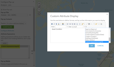

I tried to implement the DomainName function in an Arcade expression, for the Condition value above...DomainName($layer, Condition) but this results in an error:
Execution Error:Runtime Error: Identifier Not Found. Condition

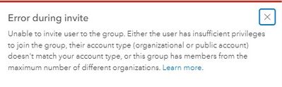

I tried to share the content with you both in a Group; RussellRoberts1 was not found, but for KenBuja I got this error message.
Error during inviteError during invite

Doing a quick test on an Analysis layer, it looks like the Domain information is not carried over from the original layer to the Analysis layer. I was trying to see whether I could load the domain from the original layer, but that wasn't working either.
As for just putting the DomainName function directly into the Custom Attribute Display (CAD), it doesn't work like that. You first create an expression in the Attribute Expressions section and then use that expression is the CAD.

I didn't try putting the Domain Name function directly in the CAD, but went via the Attribute expressions section, so unfortunately it wasn't that.
