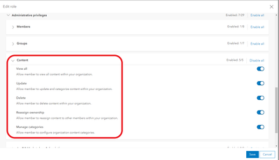

@Will it depends on what amount of "updating" you require. However, you can set up a "PublisherPlus" style role, which has all the privileges of a publisher, with the added Admin privileges from the Content tab:
That way, this super user can update other people's content.
From re-reading your question, it seems like you already suspect this. But the reason the post from 6 years ago isn't relevant is because you're looking at updating content, not the organisation site itself.
David

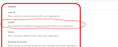

Hi David, the question is what does the permission  "Allow member to update and categorize content within your organization" actually mean?  Will that allow an account within our org to edit the contents and styling of a StoryMap or Dashboard owned by another account within our org?
