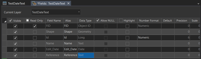

If not, could you confirm by reviewing the Fields of the layer within ArcGIS Pro, if the Asset ID Data Type is "Text"? E.g.:

Thanks for the reply. The data is coming from a GeoJson. I've then published it as a hosted feature layer. If I bring that hosted feature layer into ArcGIS pro the Data Type is indeed Text. However, when I view the data in ArcGIS online (and in Pro) the example 1-2017-10 and those like it are converted to date format. I should add that viewing the data type in ArcGIS online it still states a String.
