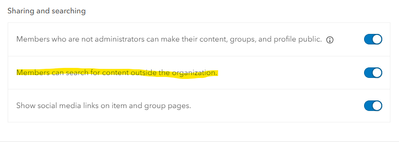

Under the Org settings is this option disabled?

Hi it was disabled, have enabled it and will check with the two members tomorrow thanks. If that was the problem then Not sure why everyone else can get to arcgis online while it has been disabled.
would that setting only take effect with new users? so if someone disabled it recently then anyone added since wouldnt have access do you think?

Its org wide, so any non admin would see the restricted search. Now all members will be able to search Online.
SallyEdwards
Thank you very much Russ all ok now, someone must have changed it at some point as it wasnt a problem until recently, so it stumped me, had looked all over for other settings but not that one 🙂
