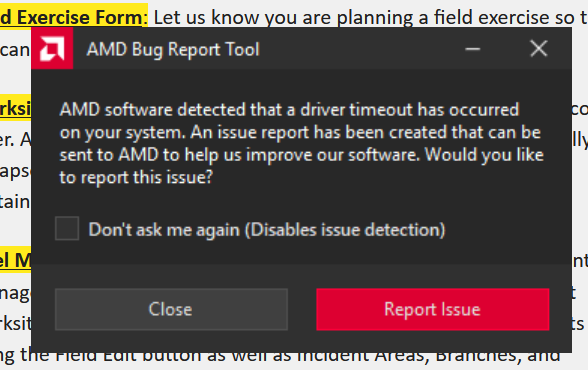

I recently bought a new computer and after configuration and setup, I began to have issues in ArcGIS Online any time I do any work in Experience Builder, Dasboards, or just webmap viewer. After regular use for a few minutes, the display will freeze up, then turn black for several seconds before the display re appears with a message from AMD stating the "AMD drivers timed out" (picture attached).

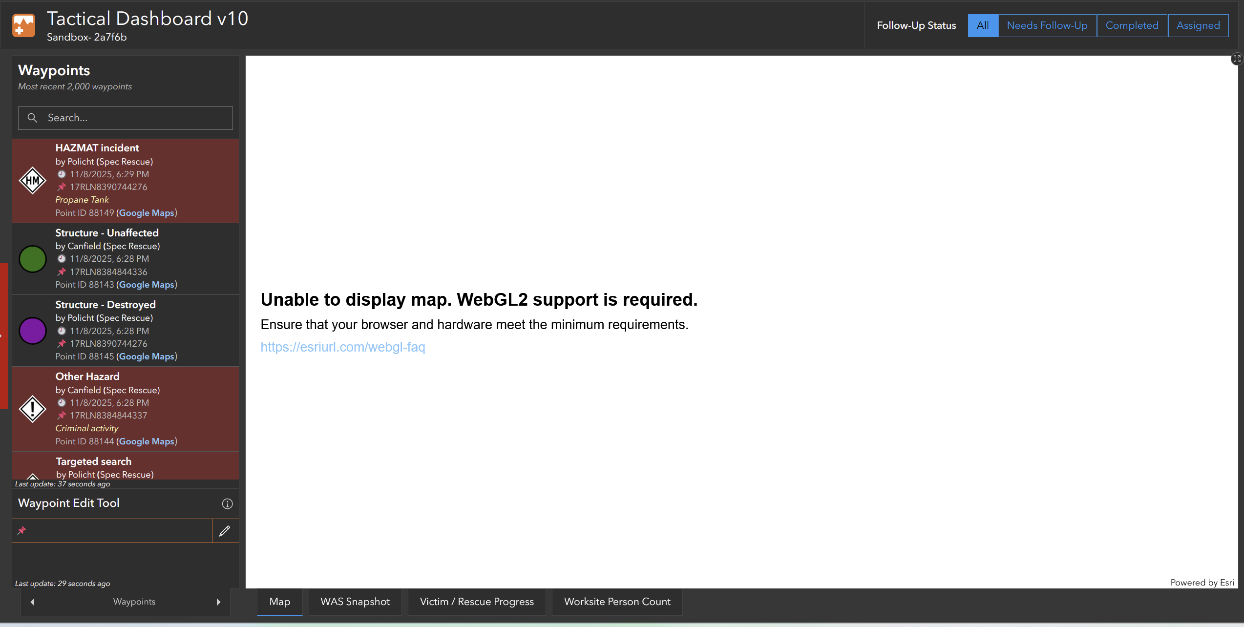

From there, any map I try to access either has an error message (simply unable to load) or a message saying "Unable to display, WebGL2 Support is Required", despite ArcGIS Online working fine moments ago. Next thing I tried was ArcGIS Pro. (edit) Pro was working as expected until this evening, now the same thing occurs, forcing me to restart pro. I was able to reproduce when editing a layout.

What browser are you using? I'm currently using Firefox, and getting this same error, but it's also on any map, I cannot open web maps, Google maps, anything. This is a Firefox issue unfortunately, a computer restart resolves it for me until the computer sleeps between workdays. I believe this is a known Firefox issue, but I'll need to find the document once again.

Seemingly this is a pretty common thing relating to ArcGIS Online and more than likely Portal. I've seen turning Hardware Acceleration for the browser on/off or just off help: https://community.esri.com/t5/arcgis-online-questions/video-card-support-for-webgl2/td-p/1390314
This is strange though, it's happening to myself as well, but I just restarted my computer and all my WebGL is back in order, this definitely could point more of a hardware issue. I'll see if I can get this more tested!

@AFackler_NAPSG it sounds like your driver is crashing, which would indicate a problem with the device. You could try running other gpu-accelerated applications and see if they also crash. If so, you may need to contact Framework and see if you can do a warranty repair, esp. if the device is new.
AndyGup
Hi @AFackler_NAPSG since you are getting a native firmware error message directly from the AMD driver, this is most likely a hardware problem, and not an issue with the ArcGIS JavaScript SDK which powers Experience Builder, Dashboards, Map Viewer, etc. You mentioned thinking the same thing in your comment here. Based on your descriptions in this particular case, the browser's WebGL2 support error message is being caused by the underlying laptop hardware failure.
