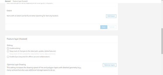

This sounds a bit unusual that it is giving different behaviour in different web browsers. Can we confirm that the editing settings are enabled for the layer under the settings page?
