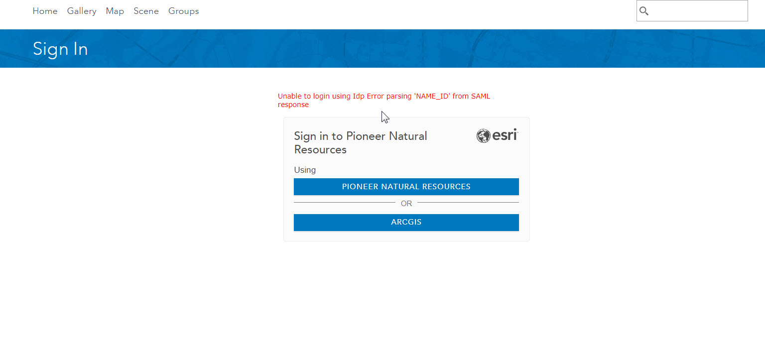

This issue started today where on occasion just signing into AGOL via web browser or through the Navigator for ArcGIS app, we will get this error.  Then it mysteriously goes away.  I contacted our guy that works with ADFS and he said that he doesn't see any issues or errors on our end.  But there seems to be an issue going on between our enterprise identity provider and AGOL's Portal for ArcGIS.
Is anyone else experiencing this issue recently where it was working normally beforehand?

That error generally indicates that the Portal (or AGOL) did not receive a nameID attribute in the SAML response sent from your ADFS.
If you happen to have Firefox, you can install a handy SAML troubleshooting tool called SAML Tracer, which will let you view the SAML response that is sent back upon authentication with ADFS (the SAML response and request are denoted in SAML Tracer with an orange "SAML" tag on the right side of the window.  Looking at that SAML response after getting this error, do you see the NameID attribute?  If not, it indicates that ADFS is not sending that attribute and in that case it might be worth having your ADFS admin take a look at the Windows Event logs for that ADFS machine.  It's probably also a good idea to confirm if this is happening to other users as well, or just your user, as that might help your ADFS administrators to narrow down the issue.
Do you have multiple ADFS instances behind a load-balancer?  Because of the intermittent nature of the issue, it could indicate that one of the instances may not be handling requests properly.

I don't have Firefox but I did see that there's a SAML Tracer for Google Chrome.  I installed that extension, logged out of AGOL and logged back in.  No issues this time around with logging in.  I looked at the SAML extension logs but did not find any attribute with "Nameid" or "Name_ID" in the response data tab.  I also exported the SAML logs (it exports as a .json file) and did a search in there for NameID but it didn't return anything.
I have confirmed that this is happening to other users as will and with the mobile app Navigator for ArcGIS.
