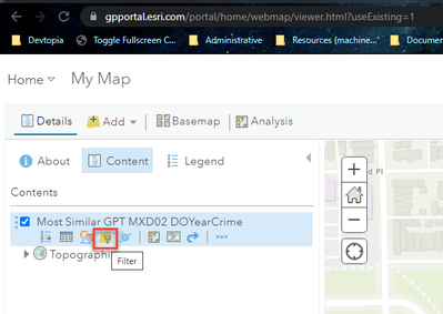

But it seems like just applying a filter on your input layer will meet your needs and is simpler, since it sounds like you only want to join features with specific values.  You can do this by clicking the "filter" button under the layer in your map, filtering for features where media_type = Curb Tie on one layer, and the other layer has curb type Building Inspector Curb Tie.
