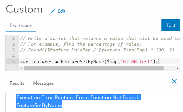

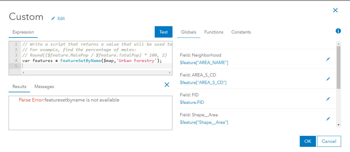

Hi I tried to use the new function FeatureSetByName in a Demo ArcGIS Online Map, and got below the errors, featuresetbyname is not available.
Then I tried it in Portal for ArcGIS and got below the error: Execution Error.
Does anybody have the same problem? any suggestions?
Thanks all

Where are you trying to apply this expression? Is it in symbology or in the label expression? If so the FeatureSetBy* functions are not available there. Another aspect to validate is the type of layer you want to do this on.

LiqiongSong1
The layers are polygon and point feature class.
And I tired to use the function on 'Change Style' -- 'New Expression' and 'Create Labels' - 'New Expression'.
Could you please tell me where can I use the function in Web Map?
Thanks.
LiqiongSong1
Thanks for the reply, and I tried it in Pop up, it works fine, so it's just not available in symbol or label...
XanderBakker
Esri Esteemed Contributor
That is correct. You can however symbolize a layer on a field created using FeatureSetBy* functions. To achieve this you should add the field and do a field claculation. The downside is that it will not be dynamic.
