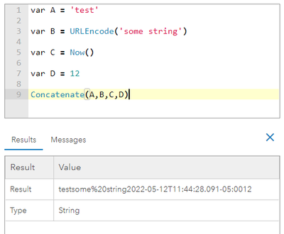

It's odd, the way you're using Concatenate isn't really documented, but it does work.
The documented use of the function is to supply an array of items and the separator character(s), and an optional formatting string (if you're concatenating dates and numbers, for instance).
Could you try writing your expression this way and see if it behaves any differently?

Tried it your suggested way and I still received the same result as I did before. I did notice that if I open the table, I can see all the correct URLs in each row. Clicking on any link will open the file It is just not working in the actual popup
