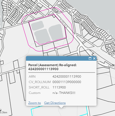

the result is this:
I don't know how to insert a logical function into this expression so empty values display "n/a"

My bad - I had the $mapp \layer wrong!
nailed it!!
Thanks for all your help - I will click solved!!
