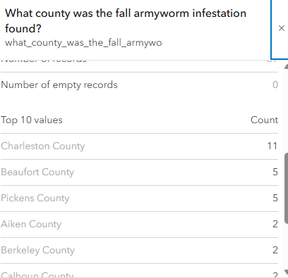

My current Survey has a location list question tied to a polygon feature layer of counties in South Carolina.  The count of the records per county is visible when the county field "Information" button is selected within the feature layer attribute table.
I was wondering if it is possible to symbolize the count per county in the polygon feature layer without using another layer, because the count is already being calculated as a summary statistic behind the scenes?

Thank you so much, Russ! I have not explored data pipelines, but will look into using them. I was wondering if it would be possible to symbolize counts by just using one feature layer (the feature layer created from the survey)
The count of the records per county is visible when the county field "Information" button is selected within the feature layer attribute table (please see screenshot below).

patriciacdale
I am not sure why the need to join to another layer when the Count is intrinsic to the dataset as shown in the screenshot provided by Grisha. It seems this should be easily handled by Arcade since it's already creating the statistic behind the scenes (Count).
