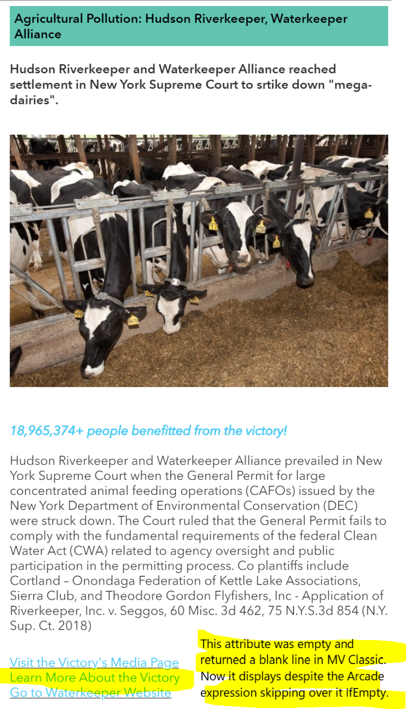

Here's the problem: I was requested to switch the order of the display such that it shows some text fields, then the media photos, and then the remaining text fields beneath that (for use in the feature information card in Web Experience Builder). When I re-order the popup info in new map viewer, the Arcade expression I used before loses functionality--all rows are displayed, even though they contain empty data, resulting in text that should be a link but doesn't have anything to link to, rather than a blank, empty line. The HTML that I try to copy over from old to new popup configuration fails. Below is a screen capture of the new popup and configuration in New MV, and following are my original Arcade expressions and the HTML in MV Classic that doesn't seem to translate in new MV.
What am I doing wrong?
Arcade expressions that worked in MV Classic (but returned a blank line if empty once formatted as links)
return IIF(IsEmpty($feature.Embeds), 'none', 'inline')
return IIF(IsEmpty($feature.Link1), 'none', 'inline')
The bottom attribute link is never empty, but the other two might be.

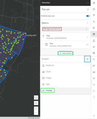

If I can chime in... there is a way to create HTML in the pop-up of the new map viewer. The way to do this is not to create an expression that appears as a "virtual field" (red rectangle below), but to add an Arcade content element (green rectangles below):

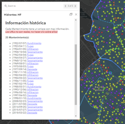

This way you can generate HTML and it will appear in the pop-up, like this example below:
You can use different styles, create lists, include multiple links stored in related data, etc...
