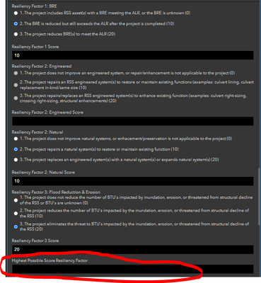

I am still new to Arcade and need some help identifying what is wrong with my below expression. I have 4 questions (see image 1). Question 1 and 4 are answered in all cases. Question 2 and 3 are answered dependent upon another question indicating whether the project is an engineered or natural solution. If they answer Engineered, then they answer Question 2, if they answer Natural, they answer question 3. There is logic that makes the questions editable depending upon the initial response. The response to each question receives a score of 0, 10 or 20.  We then give bonus points (Highest Possible Score question in image) based upon how many questions received 20 points using the below logic (image 2). My code does not return a number if any question=20, if they are all < 20 it correctly returns 0. Can anyone tell me what I am doing wrong?

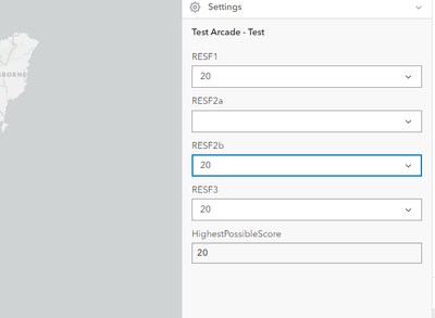

Is the "Highest Possible Score" an integer field as well? I realised my script was missing a close bracket, although I assume you fixed that to get it to run! To clarify are you setting this up in the Forms tab in a web map? I've managed to replicate it and get it to run perfectly using this code:
var RESF1Score = $feature.RESF1
var RESF2Score = $feature.RESF2a + $feature.RESF2b
var RESF3Score = $feature.RESF3
function isTwenty(i) { return i == 20 }
var num20s = Count(Filter([RESF1Score, RESF2Score, RESF3Score], isTwenty))
When(num20s==3,20,num20s==2, 10, num20s==1, 5, 0)
So I feel confident that the code I've written works and is a bit easier to understand!
It might be worth putting a very simple calculation like
return 50
to see whether the calculation is even running at all? Could you post a screenshot of the questions in the form builder as well?
