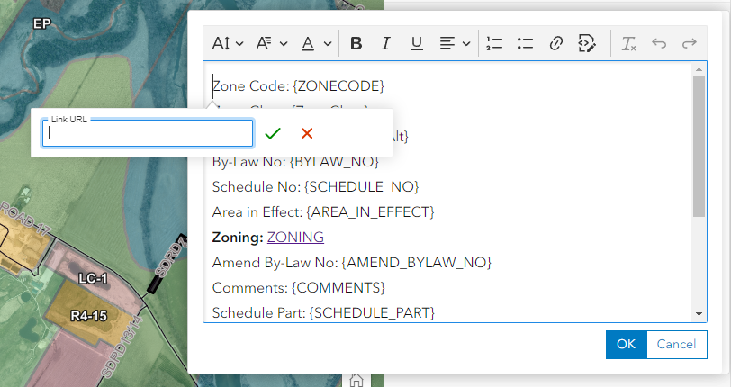

I'm trying to add URL's to an online document that will scroll to a specific page of the document depending on the feature selected. This is all based on building zones, for example, if an 'R1' Zone is selected, clicking on the URL in the pop-up will scroll to page 108, if the 'CC' Zone it will scroll to page 152, and so on.
I know that it's possible to put in a single URL using the method in the image below:
But that doesn't allow for URL variation depending on the zone. For example: '<baseurl>' + '#page=108'
When I attempt to create an Arcade expression to allow for this, it just adds the URL as text, instead of being a clickable link. I also am unable to use HTML code in Arcade, so I can't figure out how to make it a word (Ex. Click Here) instead of the entire URL.

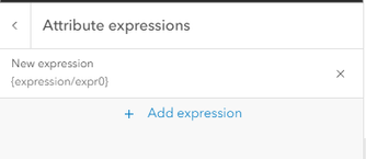

I think I ran into a situation like this before with one of my projects. I would create a separate Arcade Expression (Expression01) to create the URL link and then, in your popup, reference Expression01 as the source of your hyperlink. I think this way the "on the fly" link is actually constructed before it is presented as a URL link in the pop up.

You need to create a new expression that contains your if else and any other code you're using, this expression includes your URL.
and then you add {expression/expr0} to wherever you wanted to put the URL in your pop-up.

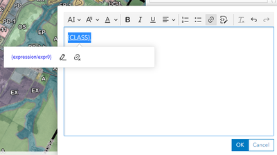

CaitlinParker2
This thread was really helpful, but took me a minute to understand how to use the attribute expression to make the URL. My expression looks like this:
var web = $feature.Website
return web
The important part is the {} expression below what I renamed the expression:
 When you go to hyperlink the text in your text box, you have to use that {} expression specifically rather than the name.
