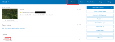

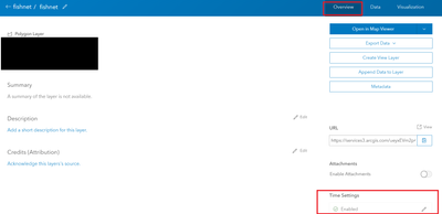

JayantaPoddar
MVP Alum
Is it a Hosted Feature Layer?
Are you following these steps?
1. Go to Item Details page of the Hosted Feature Layer
2. Scroll down to Layers section > Click on the name of the layer
3. In layer details page > Overview Tab > Scroll down to see "Time Settings". click the "pen" icon to enable the time with appropriate field.
