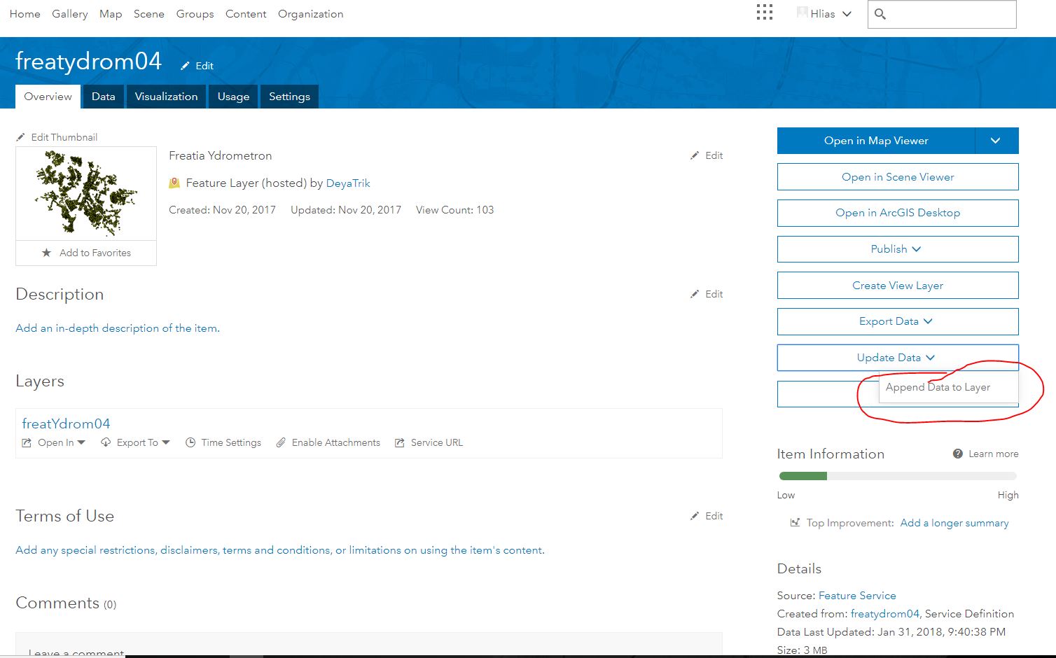

There is a hosted feature layer with 7559 points in AGOL. We created 1000 more and wanted to append them to the hosted feature layer. The schema was a perfect match as it was downloaded from the same feature layer that was to be updated.
 Append screenshot 1
I used the new Update data functionality for hosted feature layers.

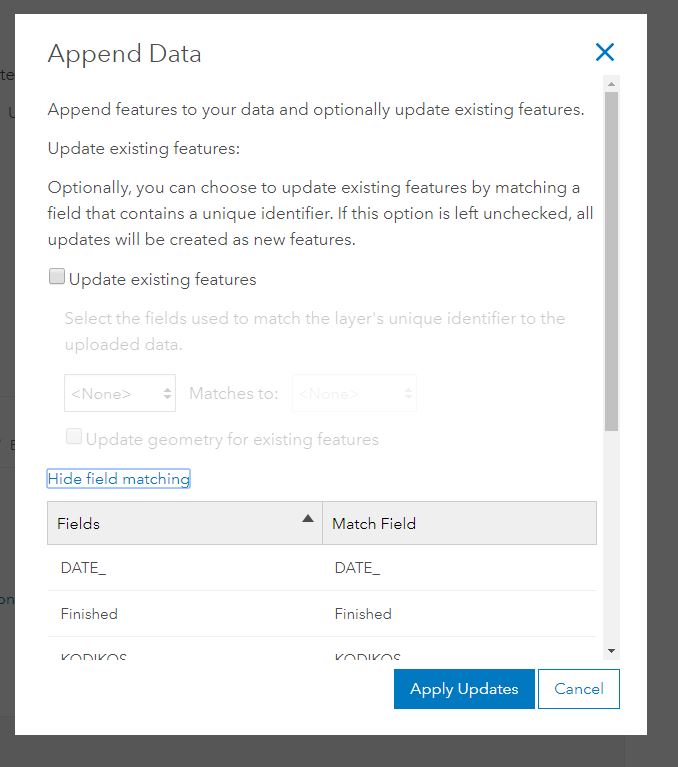

Append screenshot 2
When i applied the updates all previous points were deleted and i could see only the new ones.
Why could this happen?
Is there any way to retrieve the old points?

The analyst on this case was never able to reproduce data loss with the append tool as described above. Furthermore here in Support we have not received any other reports of data loss as a result of running the Append tool.
If you want to be super safe you can always export a back up of the service to File Geodatabase or Shapefile before running the tool.
KostasFrantzios1
Support was able to retrieve all the data so there was no actual damage. However as Katie mentioned you should try it in a test feature layer and export a backup of your data.

As Katie Cullen  mentioned, Append does not cause a loss of data as existing fields are updated and never deleted. If incorrect information is appended and the wrong values are updated to the wrong fields,it's never a bad idea to create a back up of your data when performing large append operations. With bulk operations it can be difficult to review every feature before appending, and having a back up handy can make life easier if the wrong data is appended.
