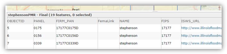

From your featureclass attribute field, it looks like you are using a Label Expression with the PANEL field for your labels.  Could the Label Expression be hanging things up?  Might you try creating a new "Label" attribute field with "PMR "&[PANEL] and then use that field for your Label property?
kingsleyallan
Thanks for the suggestion.  I switched the label to a different field with no prefix text, but the result is still the same, it shows in the viewer version, but not in the embedded map.

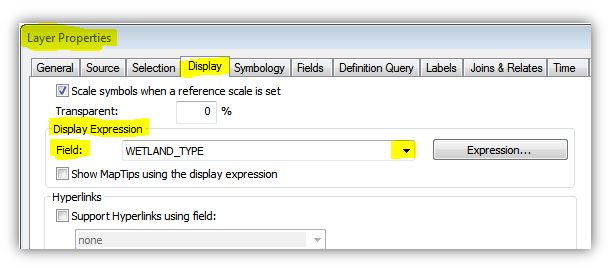

First, are you using Labeling from within AGOL or are you using labeling in your source ArcMap/map service?  Try serving labels from ArcMap.
Secondly, this is my long-shot:
In ArcMap, go to  >Layer Properties  >Display tab
What field is shown in the >Display Expression >Field drop-down option?
Change it to FIRM_PAN, Save and republish.  Any joy?
