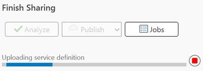

Any idea when im trying to publish a new layer to AGOL its taking 30+minutes to finish?

It's been sitting on this prompt for 30+ minutes. This usually takes 3-5 minutes. Even exporting layers have been taking way longer than usual.

This is a layer with 600 items and all I was doing was sending it to Agol.. and it's just spinning the wheels.

I canceled it and re started and it took 3 minutes to finish this time.
